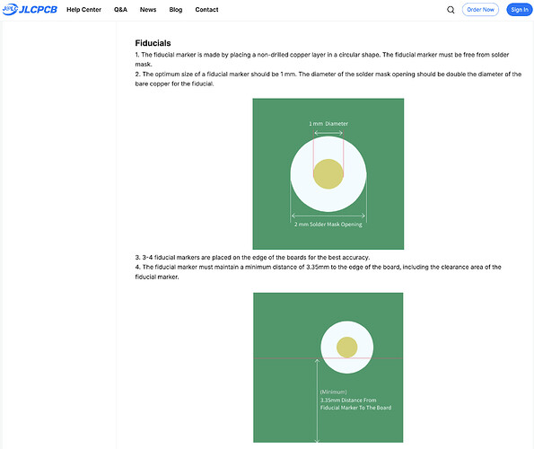

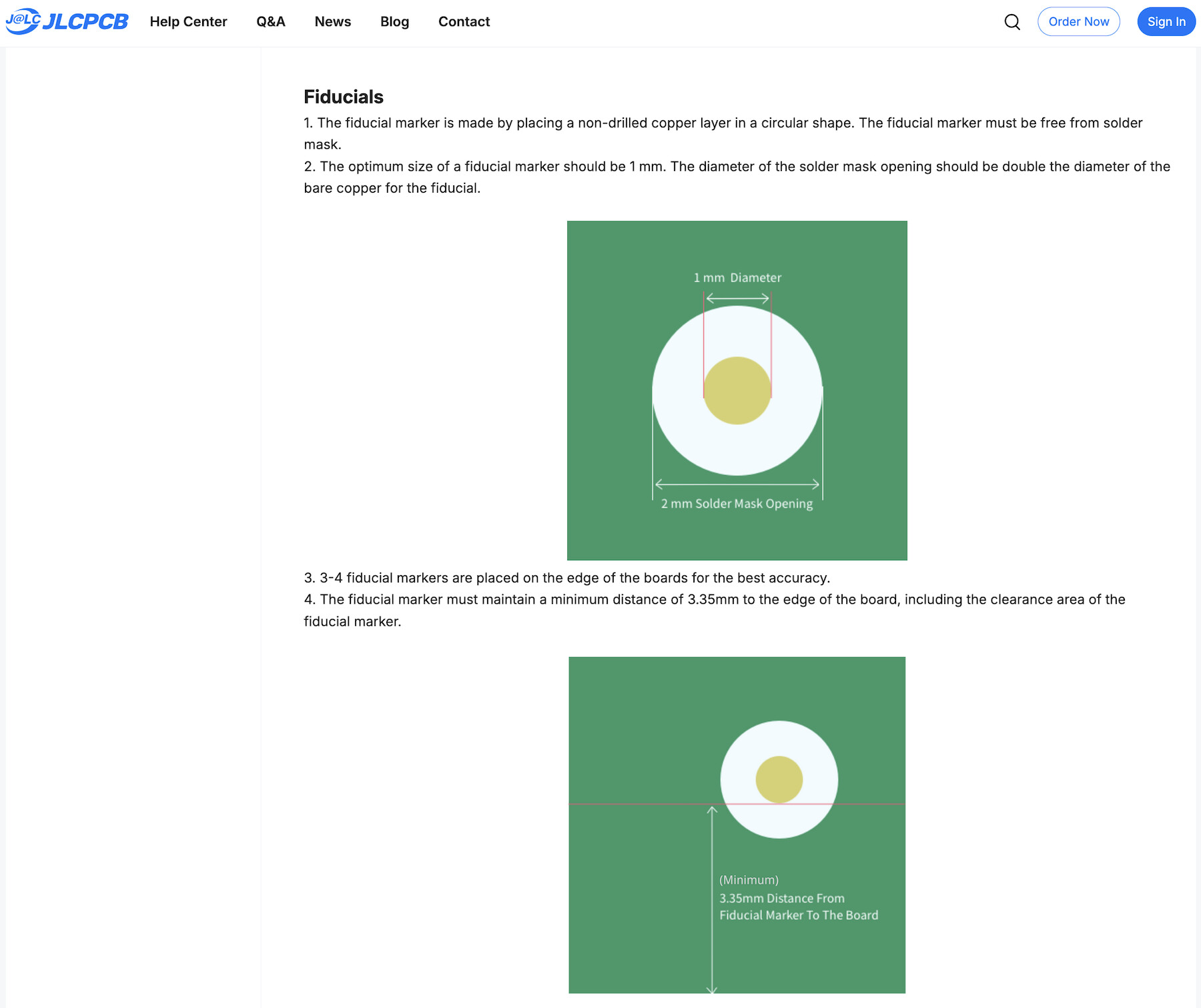

From JLCPCB (similar info as @eelik posted)
