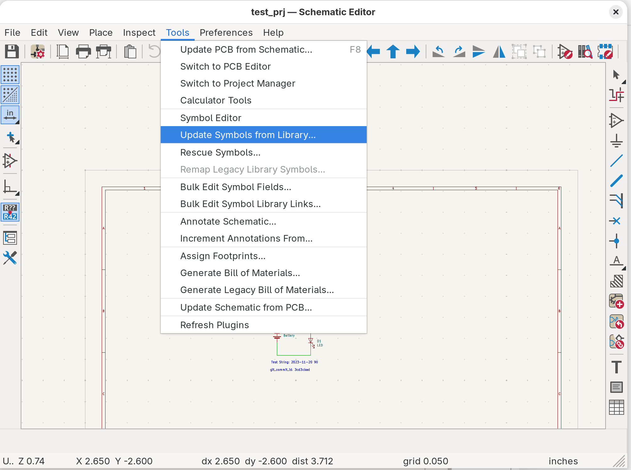

This is a bug, nothing to do with the libraries changing. The first time pressing “update footprints from libraries” could be the libraries changing, but the 2nd, 3rd, ….could not be the libraries. It always changes the pcb file.
This similar “update symbols from library” menu in the schematic does not have this issue.

The fix still has some problem. PCB file depends on both the schematic and the footprints. So actions ‘update pcb from schematic F8’ and ‘update footprints from library’ should be mixed to see if there are some problem.
When ‘update pcb from schematic’ is commanded on the example project, it will add 3 units blocks to the pcb file:
(units
(unit
(name “A”)
(pins “1” “2”)
But when ‘update footprints from library’ is commanded, these three units blocks will be removed.
