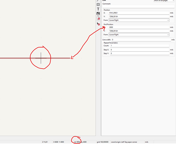

I’m new to KiCAD (but not new to PCB Design) and I want to determine if KiCAD is to be of use for a company, so I tried out a lot of things. So I did with the Drawing sheet editor to create a template for our needs. I already stumble about the “snap to grid”, because I setup all values to the recommended value of 50mils (schematic and symbol). But the drawing editor doesn’t care about the settings. What went wrong? (see the screenshot below, the simple line is of grid)

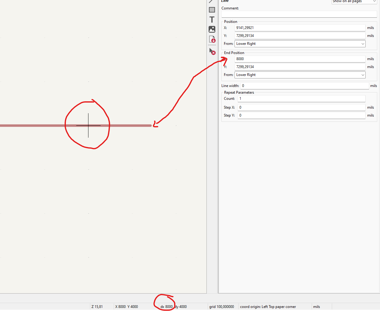

I can add to what Paul said, KiCad 9.0.4 behaves in the same weird way:
But it adds a random 141,29921 mils. No clue what is happening here - but it doesn’t seem to be a new issue.
If I manually set the end pos to x=8000, this happens:
Internally KiCad works in metric, with integers on a nanometer scale. That is why the decimals stay the same regardless of the whole MM grid I work on.
There is also no need at all to work on a 50mil grid in the drawing sheet editor. It is only an important issue for electrical connections in the schematic, as all the symbols in KiCad libraries are based on an 1.27mm grid. (And 2.54mm pitch between pins of the symbols).
I am mildly curious if others see the X.989 and Y.0022 numbers when working on a metric grid (with whole millimeters).
For the rest, I see this topic as an oddity, and something that should be fixed (probably has tho be reported first). But it’s not a very important issue.
