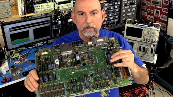

Last time I was using curved tracks was when as teenager (and little later) I was drawing my tracks (using ballpoint pen refill with ballpoint removed) directly at PCB.

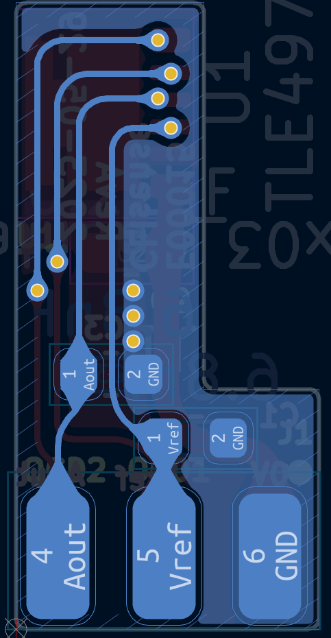

I don’t need to see anything to just use 45° tracks and not plan to change it. I sometimes use rounded tracks when I am constructing coils only.

Which is fine, and useful for copying vintage hand drawn boards
And it feels nice, if you imagine it is a water slide and you are on it. :rofl:
