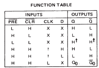

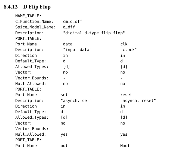

Thank you jmk. I’m building a subckt based on an ngSpice provided digital model, here is an excerpt from the manual.
I was assuming this truth table, taken from a 7474 chip, there was no truth table in the ngSpice manual. This table assumes inverted PRE/CLR, but I suspect the d_dff does not?
I would be using the “Clocked” state.

It does seem the Spice model does not have inverters on the S & R (Pre & Clr). Maybe the Name Table Port Names “set & reset” instead of “not-set & not- reset” are a hint, but I don’t know because I have still not involved myself with the Simulation section of Kicad.
I was just scratching around some ancient data books. TTL has inverters on their direct inputs but cmos does not, with respect to D ffs. I suppose the reasons are lost in the mists of time.
I think you nailed it jmk, I tried many different permutations of components, netlists and signals; hard to remember. After hours in the chair, sore neck and a headache I think it might be overlooking the ‘not’ bars. I did a quick test before quitting that showed promise.

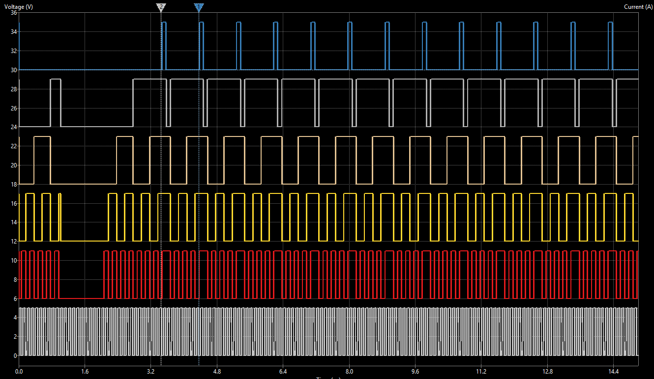

Things working as expected now, it’s a beautiful thing! Thanks everyone.
Divide by 9 counter, or close enough for now.
