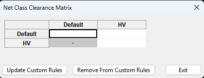

We have developed an external plugin for KiCad’s PCB design software, enabling users to create custom rules for clearances between net classes through a user-friendly and practical matrix-based GUI.
icon
The plugin is named Net Class Clearance Matrix (NCCM) and is available on our GitHub profile, the exact repository linked here. The installation instructions and user guides can also be found on the repository page.
NCCM was written using wxPython and the new KiCad IPC API. At present, it can only be installed manually due to complications with installing IPC plugins through KiCad’s internal Plugin and Content Manager.
Please feel free to ask any questions; we would be more than happy to provide answers and support to those who are interested, and feedback on your experience would be greatly appreciated as well.
