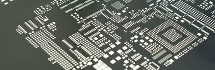

I am wondering if someone already tried to create a custom drc rule to check if the stencil?
it’s suggested to have a stencil aspect ratio > 1.5
and a area ration >0.66
as I know which stencil thickness I am going to use, those values might be auto-checked in a custom drc rule (or an exteranl python tool)
