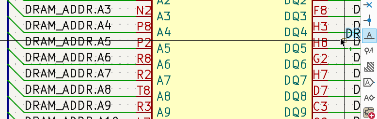

Clicking on right toolbar icon selects the net under the icon
I think I just noticed a bug in 9.0.6.
I’m connecting a DRAM in the schematic editor. Many of the connections are to nets unfolded from several buses. I needed to create a local label, so I clicked on the toolbar icon on the right side of the screen. Rather than popping up a dialog box, it created a local label with the name of one of the nets under the toolbar icon:
I figured I’d mistakenly clicked on the net name, or some other sort of operator error, but I’m able to recreate it. It seems to depend on exactly where the mouse pointer is within the toolbar icon.
Has anyone else seen this?
I filed a bug report on this: #22433.
