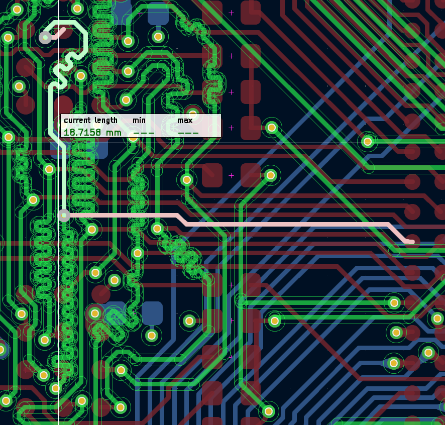

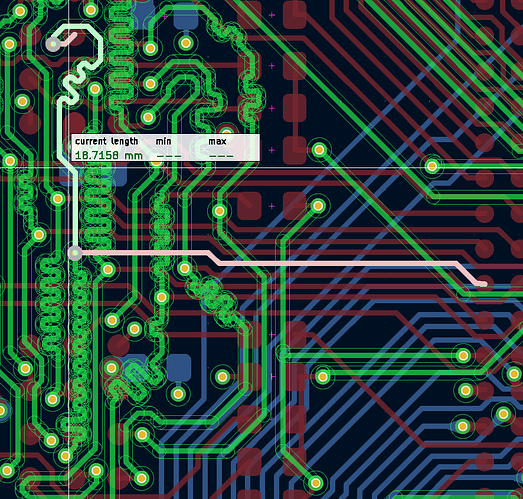

I push “7” (hotkey for length tune single track), I hover over the track and length is displayed.
Length calculation to Memory1:
Calculation for memory 2:
These are fine.

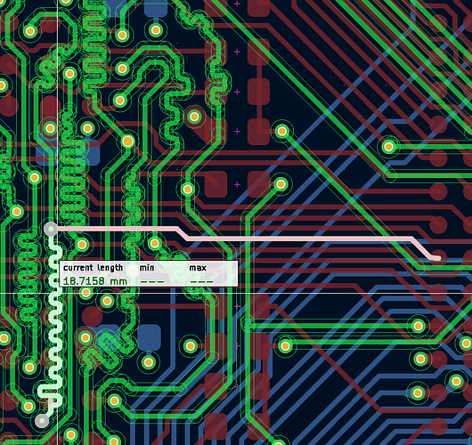

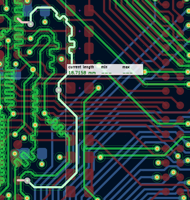

But for another track:
but what I’d like to see:

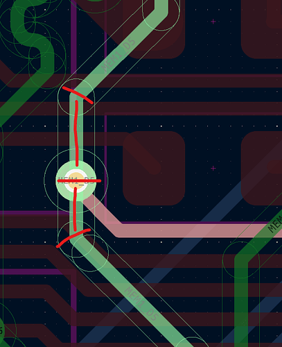

So my question is: how does algorithm select segments of a Y-shape track? How to modify this behavior? The only workaround is to separate the segemnts at the central via, measure all 3 segments individually, do the length-tune, then reconnect the parts…not too comfy:/
This actually looks like a bug - the route-finding code is meant to stop at a complex node (ie one with more than two tracks) as it has no idea which should be followed. Which version are you running?
I’m afraid tuning in your situation is not yet supported.

It is not supported but can be managed with the workaround: do tuning in separate steps for each branch.
  • temporarily remove the upper short segment to the central via
  • do the tuning
  • reconnect the particular short segment.
  • repeat with the other branch(es)
This is a poor arrangement, there will be a strong reflection at the fork. A daisy chained approach is better for signal integrity
