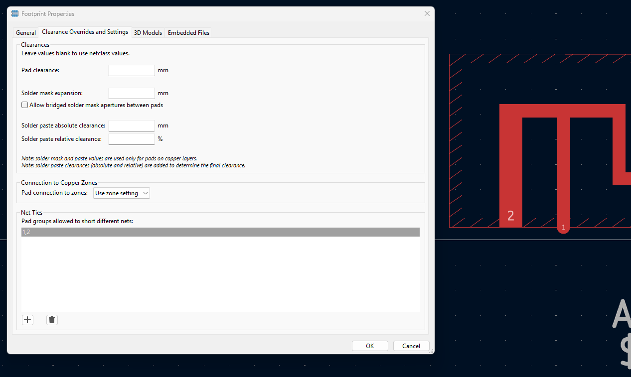

I have designed a Bluetooth antenna and used the net tie override to prevent a DRC error, but I still get an error
The two pads (pin 1 and 2) have been added to the net tie override…
So why do I still get a DRC error ?

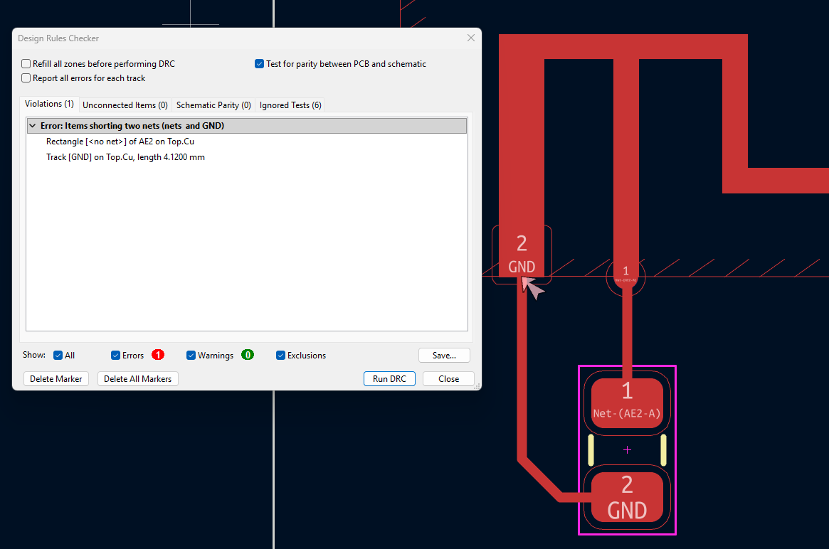

I suppose the key is <no net> in Error
What does this mean and how do I fix it ?
I don’t know, but I think you should not have any piece of copper being no net.
